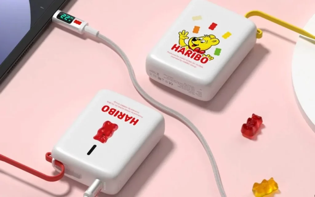

    The once-viral Haribo-branded power banks have quietly disappeared from Amazon in the US and for good reason. A recent CT scan of the 20,000 mAh model revealed a major design flaw that could pose serious safety risks, including overheating and potential fire hazards.

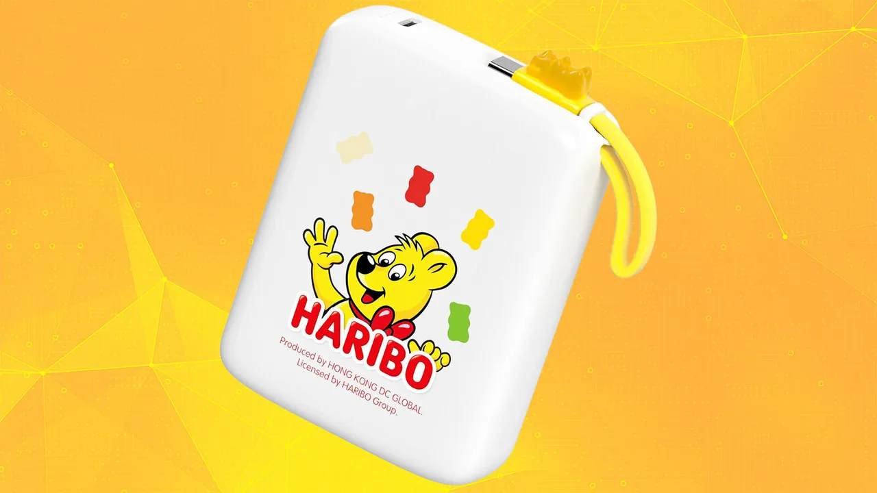

    While these power banks made waves earlier this year among ultralight gear fans for being surprisingly compact and cheap, their internal construction may be too good to be true. According to a report by Lumafield, a CT scan of the 20,000 mAh version shows the two battery cells misaligned and loosely stabilized, with visible gaps and poorly placed electrodes.
    This kind of sloppy internal design increases the risk of premature failure. More importantly, it can cause thermal hotspots, reduce battery life, and under stress lead to dangerous outcomes like overheating or combustion.

    At a glance, the Haribo power banks checked all the right boxes: fun branding, high capacity, low weight, and rock-bottom pricing. But power banks aren’t just accessories they’re compact lithium-ion energy storage devices. When internal components aren’t properly stabilized or aligned, the consequences can be dangerous.
    Here’s what the CT scan uncovered:
    • Cells were misaligned and unevenly spaced
    • Electrodes lacked internal stabilization
    • Potential for reduced lifespan and overheating
    • Manufacturing inconsistency not visible externally
