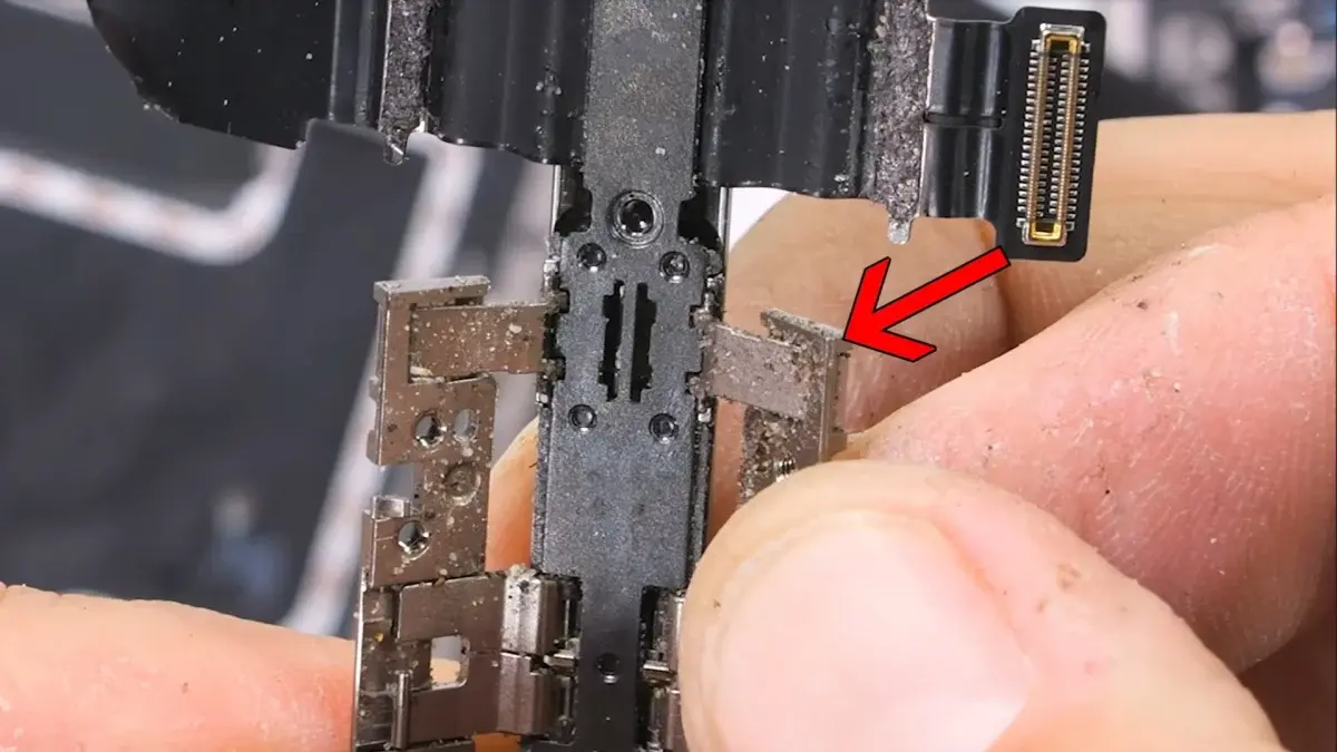

    Reports regarding screen durability issues on the new iPhone Duo have begun to surface, with users noting consistent cracking along the device’s internal hinge. As the first foldable smartphone from Apple, the iPhone Duo has garnered significant attention, but these recurring failures at the same specific location on the display have raised alarms among tech experts. A recent teardown analysis suggests that a hardware defect within the hinge mechanism might be exerting pressure on the flexible panel from behind. This mechanical flaw appears to be the primary suspect behind the localized damage reported by consumers worldwide.

    Tech enthusiast and YouTuber Zack Nelson recently performed a detailed teardown of the iPhone Duo on his JerryRigEverything channel to investigate the root cause of these display failures. During the process, he identified a particular piece of hardware situated directly behind the folding point of the screen. He informally labeled this part the “Pixel Pincher 9000,” theorizing that it protrudes into the back of the delicate flexible display.
    The theory posits that a loose screw or a misaligned guide component allows this metal piece to press against the screen every time the device is folded or unfolded. Because this movement is repetitive, the pressure becomes a critical point of failure for the panel. This explanation aligns with the observation that the cracks occur in a uniform pattern across different affected units, distinguishing this issue from random debris damage.

    While some users have expressed concerns regarding dust or sand particles entering the hinge mechanism, experts distinguish this from the specific internal cracking issue. External debris typically causes random damage at various points on the display. In contrast, the documented iPhone Duo failures remain concentrated in one specific zone, pointing toward the internal hinge component as the culprit. This distinction is vital for understanding how environmental factors and hardware engineering interact within the device.
