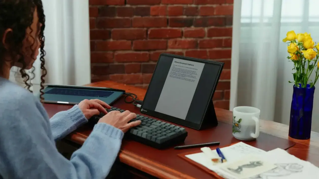

    Modos has officially introduced the Modos Flow, a groundbreaking 13.3-inch E-Ink monitor designed to bridge the gap between traditional electronic paper and high-performance display technology. Unveiled after six years of rigorous development, this device utilizes an E-Ink Carta 1300 panel to achieve a 60Hz refresh rate, a significant leap for the industry. Featuring a 3200 x 2400 resolution and a density of 300ppi, the monitor is currently seeking funding on Crowd Supply. The project targets professionals and users who require a paper-like viewing experience for extended work sessions without the typical drawbacks of standard e-reader displays.

    Users Benefit From Versatile Customization Options
    Functionality remains at the forefront of the Modos Flow design. The monitor includes USB-C for data and power, allowing users to move between workstations with ease. The software interface provides granular control over screen parameters, including color saturation, front-light intensity, and color temperature. These features are essential for users who suffer from eye strain and require a display that mimics real-world lighting conditions.
    Furthermore, the display includes active digitizer support, making it compatible with pens for drawing or note-taking. Because the monitor functions as a secondary or primary PC display, creative professionals can use it to draft documents or sketch layouts without the harsh blue light emissions of traditional LCD or OLED monitors.
