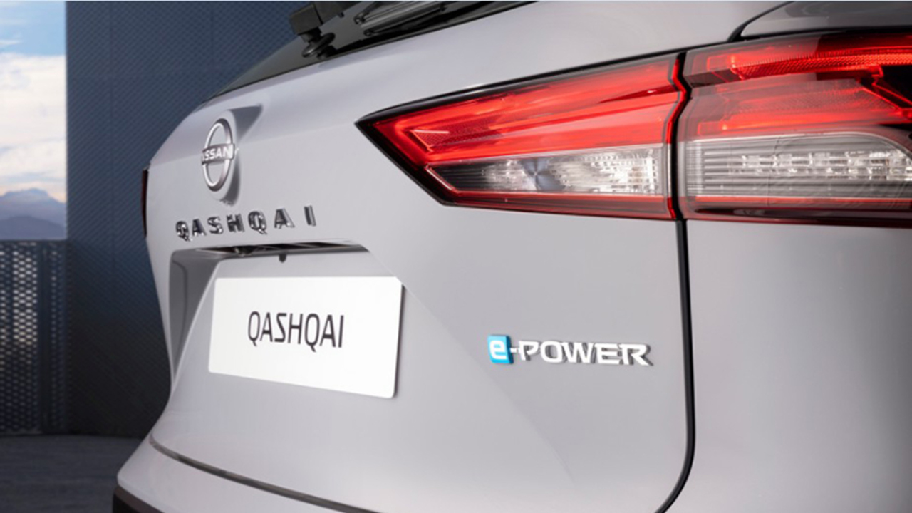

    Nissan has announced a comprehensively updated version of its e-POWER technology, introduced four years ago. The system, which will be available for sale with the new Qashqai in September 2025, utilizes the internal combustion engine solely to generate electricity. This technology, which enables electric driving without external charging, offers significant improvements in both driving comfort and efficiency.
    The new e-POWER system once again features dual motors. The gasoline engine does not directly power the wheels; it only provides energy to the generator. This energy is transferred directly to the electric motor via an inverter, which drives the wheels. Unlike traditional hybrid systems, it eliminates complex transmission structures. This design ensures the instantaneous response and quiet operation of electric vehicles.
