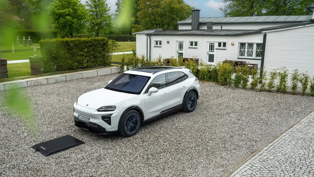

Porsche has officially introduced a groundbreaking wireless charging solution for its electric Cayenne models, marking a significant shift toward enhancing convenience for electric vehicle owners. Announced as an optional feature in the European market, this technology effectively eliminates the need for manual cable connections, streamlining the daily charging routine. The system, which is manufactured at the company’s Bratislava facility in Slovakia, utilizes a base plate installed on the ground of a garage or parking space. By leveraging an integrated unit beneath the vehicle, the system facilitates energy transfer through an electromagnetic field, ensuring that the electric Porsche Cayenne remains charged without physical intervention.

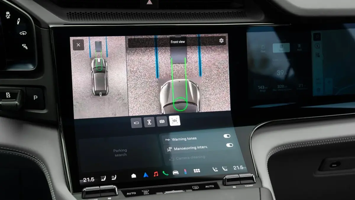

- The technology integrates with the existing Park Assist software to ensure precise alignment for optimal energy transfer.

Operating on a principle similar to that of modern consumer electronics, this wireless system provides performance levels that rival standard wall-mounted home chargers. With a power output reaching 11 kW, the technology ensures that the vehicle charges efficiently without significant energy loss. Porsche reports that the power transfer efficiency from the grid to the battery reaches 90 percent, demonstrating that wireless capabilities are now comparable to traditional wired alternatives in terms of overall effectiveness.
To assist drivers in positioning their vehicles correctly, the system communicates directly with the Cayenne’s built-in Park Assist software. This integration guides the driver to park with millimeter-level precision over the ground plate. Once the vehicle is properly aligned, the charging process initiates automatically. This seamless automation removes the physical burden of handling heavy cables, particularly in private residential settings where convenience is a primary concern for owners.
