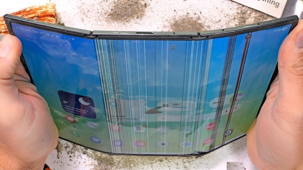

At just 0.15 inches thick in its slimmest spot, the TriFold was always going to be fragile. But even before the actual bend test started, things already looked rough. When the phone was folded incorrectly rear camera side in first the device vibrated and strained, despite Samsung’s own warning not to do exactly that.
That alone set the tone for what came next. Unlike previous Z Fold models that have withstood years of teardown abuse, the TriFold broke. Fast.

The bend test ends exactly how you think
When folded the wrong way, the TriFold’s hinges fail and the frame gives out. Zack bends the device backward, and it doesn’t just creak it snaps. It’s a clean break, and the moment marks a first for Samsung: their flagship foldable fails the physical test.
