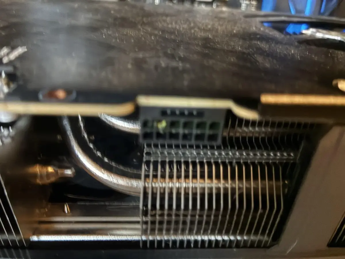

Concerns regarding power consumption and thermal stability for NVIDIA’s GeForce RTX 5090 series have intensified following reports of hardware failure. A user reported that an MSI GeForce RTX 5090 Gaming Trio OC suffered catastrophic physical damage to its power connector during intense DLSS 5 Neural Rendering testing. According to GPU-Z monitoring logs, the graphics card maintained a sustained power draw of 613.5 Watts throughout the stress test. This incident highlights potential vulnerabilities in the 12V-2×6 power delivery system when subjected to the extreme and continuous loads required by next-generation neural rendering technologies.
- The MSI GeForce RTX 5090 Gaming Trio OC experienced a melted 12V-2×6 power connector during prolonged DLSS 5 neural rendering stress tests.
- Hardware logs confirm the graphics card maintained a continuous power draw of 613.5 Watts, significantly exceeding standard operational limits.
- The physical damage resulted from extreme thermal stress as the connector failed to manage the sustained electrical load required for AI-driven rendering.
Continuous Power Loads Challenge 12V-2×6 Connector Limits
The MSI Gaming Trio OC is factory-configured with a power limit of 575 Watts, yet the implementation of DLSS 5 technology pushes the hardware far beyond its expected parameters. Under heavy neural processing loads, the GPU quickly surpasses its standard 450-Watt consumption profile. While the PCIe slot provides approximately 75 Watts of power, the remaining substantial load is directed entirely through the 16-pin 12V-2×6 connector.
In the documented failure, the system experienced an abrupt shutdown, followed by a strong burning odor, confirming that the plastic socket housing had melted and fused with the cable terminals.
