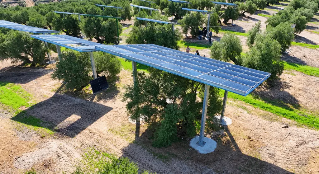

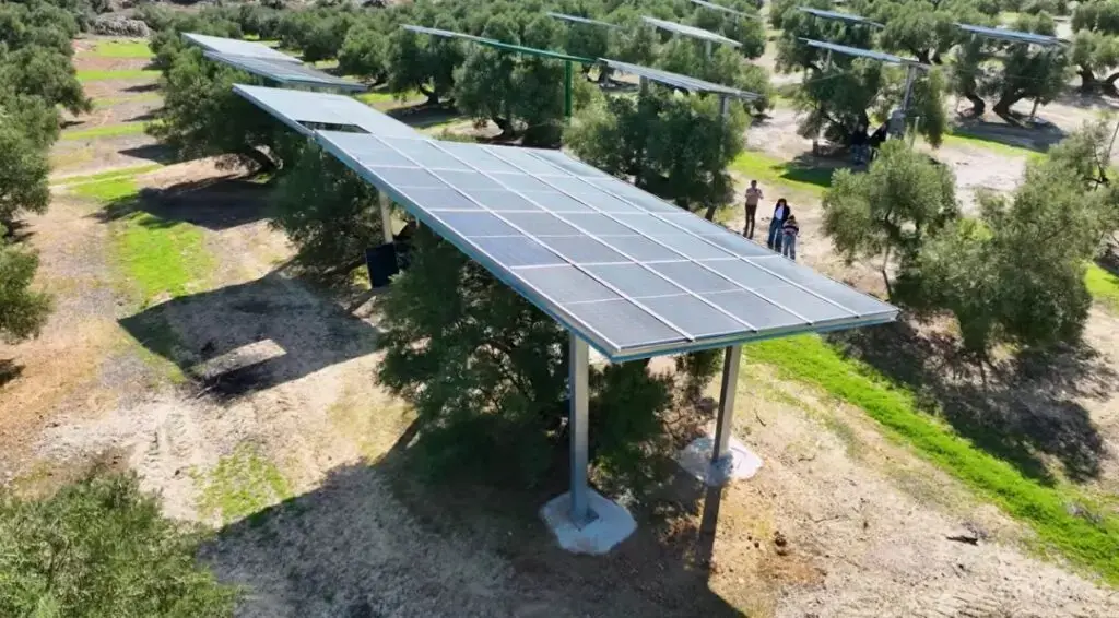

Acesur, a prominent Spanish olive oil producer, has launched a pioneering agrivoltaic project at its Vilches facility in Jaén, Spain, by installing a massive solar power plant directly above its existing olive trees. Developed by the Granada-based firm Greening, the 3.65 MWp installation utilizes over 5,150 solar panels elevated four meters high to ensure that agricultural production remains undisturbed. This innovative initiative, supported by a 2.8 million euro grant from the Institute for Energy Diversification and Saving (IDAE), aims to supply nearly 95% of the adjacent bottling plant’s electricity requirements while preserving every single tree on the plantation.
- The project features 5,150 solar panels elevated four meters high to accommodate mechanical harvesting equipment.

Elevated Panels Allow Harvesting Machinery to Pass Underneath
The technical design of the Vilches plant is specifically tailored to the requirements of modern olive farming. By mounting 5,150 solar panels on steel pillars anchored in concrete, the developers have successfully raised the energy infrastructure to a height of four meters. This specific elevation is critical because the harvesting machinery used in the Jaén region typically reaches a height of 3.5 meters. These machines operate by gripping and shaking the tree trunks to release the fruit, and the elevated structure ensures they can maneuver freely throughout the grove without any risk of collision.

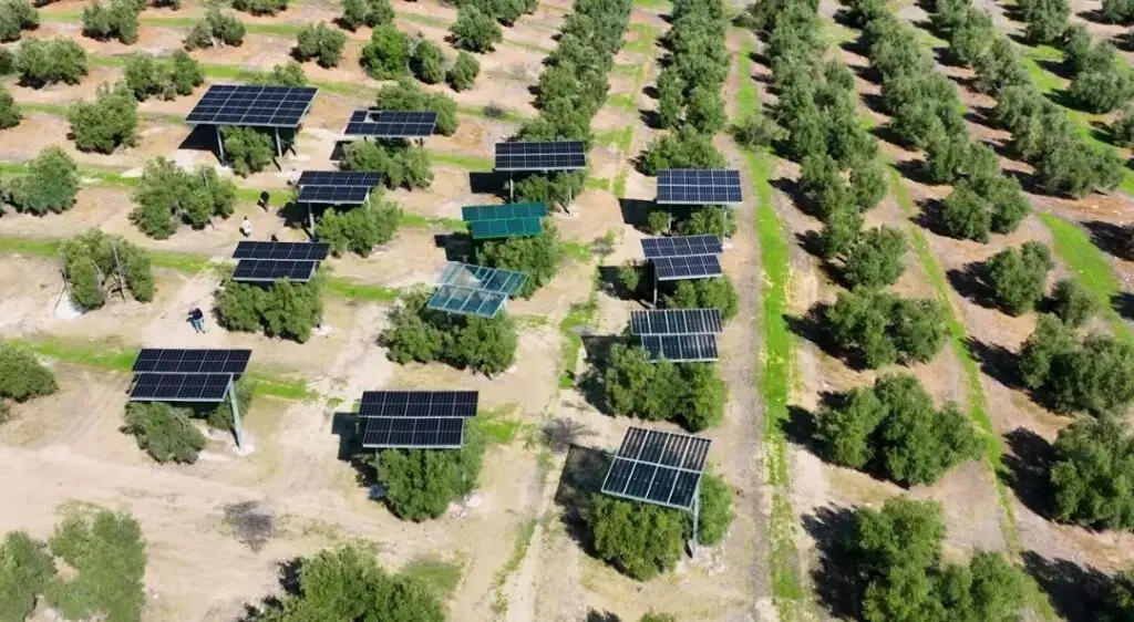

Control Areas Provide Data for Future Agrivoltaic Standards
Because the trees in Vilches have not yet completed a full harvest cycle under the new solar canopy, the long-term impact on productivity remains to be seen. To address this uncertainty, the project includes a rigorous scientific monitoring component. Approximately 20% of the land has been left without panels to serve as a control area. Researchers from the University of Jaén are currently using this space to compare the performance of shaded trees against those in open fields. They are specifically measuring water stress levels, soil temperature, and overall fruit quality to determine the feasibility of this model for other producers.
